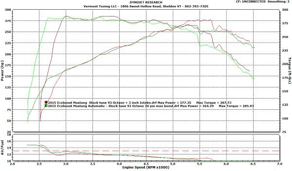

Simply replacing the factory intake pipe between the air filter housing and the turbo can produce significant performance gains without additional tuning. I picked up ~ 13hp at the wheels between 5000 and 6000 rpm with a 3" intake I made for my Ecoboost:
Cheers,
Brian
