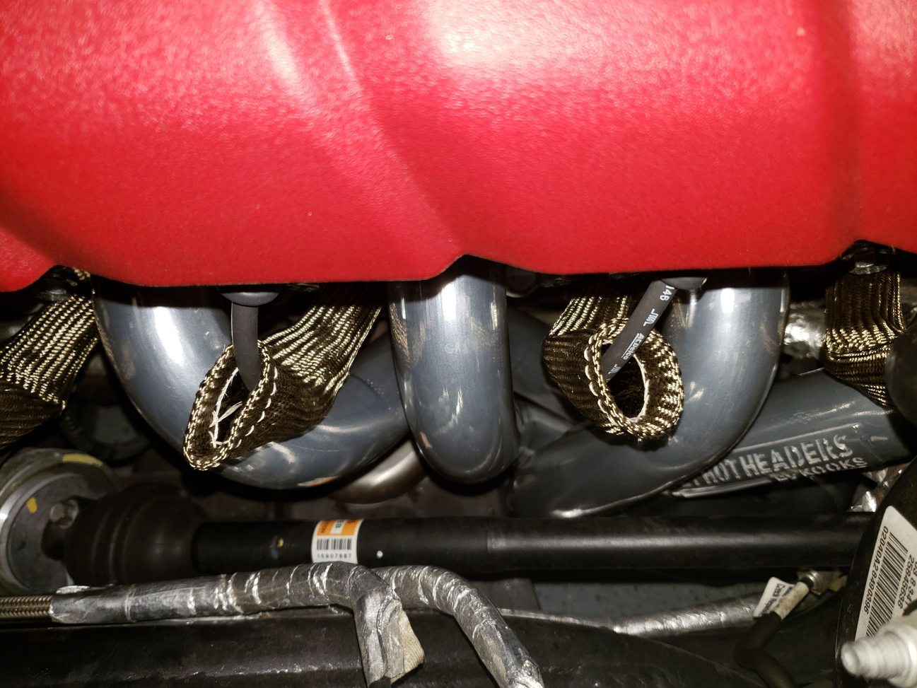

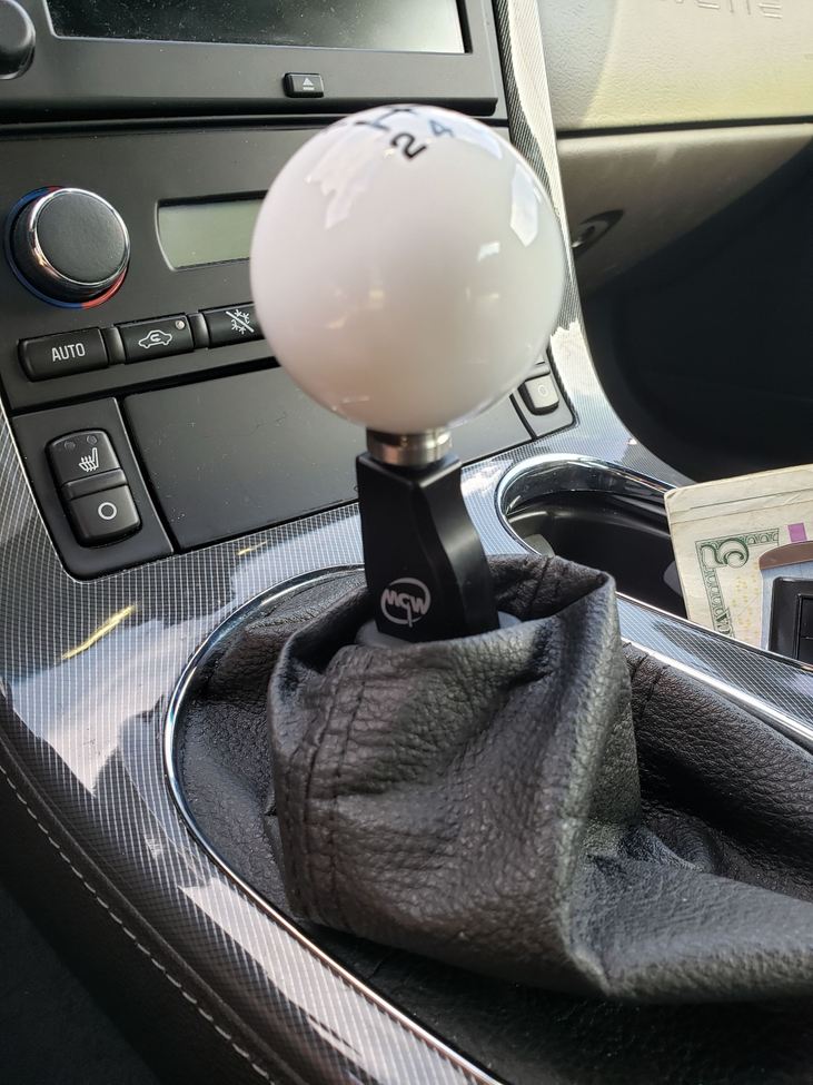

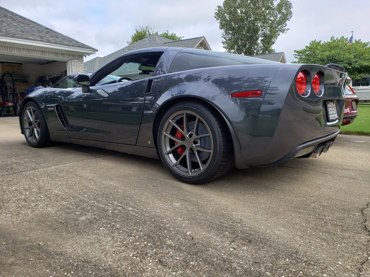

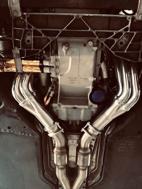

So there's been very little posting going on for a while now. I really have nothing new to report as far as the wife's '16 Ecoboost. I imagine once I get her a new daily driver and I inherit her Mustang as my DD I'll start performing some mods on it, but for now it will stay stock. However I HAVE been busy modding my '09 ZO6. Although this is a "Mustang" site I know we're all gear heads and are united in our love of all things that make noise & go fast! So with all that said here's a little rundown on what I recently accomplished on my 'Vette.
I replaced all the shocks with DRM Bilsteins. I also replaced the front/rear sways bars with a beefier set from Johnny O'Connell. New OEM rotors and a set of Carbotech 1521 brake pads were installed all around. A set of Kooks Jet Hot coated LT's and a Kooks catted x-pipe replaced the stock exhaust setup. I also installed a MGW flat stick short throw shifter. A Halltech MF103 CAI was installed replacing my original Halltech Super Bee CAI. Last but not least I had all 4 of my OEM Competition Gray Spyder wheels stripped and powder coated and then wrapped in a new set of RE050a Pole Positions.
I then drove the car up to Detroit and dropped it off at Katech. Katech works closely with the GM Corvette race team and does a lot of work on their motors. I opted to have Katech perform a Stage II upgrade on my car. The upgrade consisted of the following:
-Camshaft - Torquer 116 (very mild cam)
-Katech C5-R timing chain
-PSI springs
-Katech Titanium retainers
-Bronze valve guides
-Katech Ti/Mo intake valves
-CNC ported cylinder heads
-FAST LSXR 102mm intake manifold
-FAST installation kit
-Wideband O2 bung
-Head gaskets
-ARP head bolts
-160 degree thermostat
Here's what my engine bay looks like now:
More pics of the upgrades:

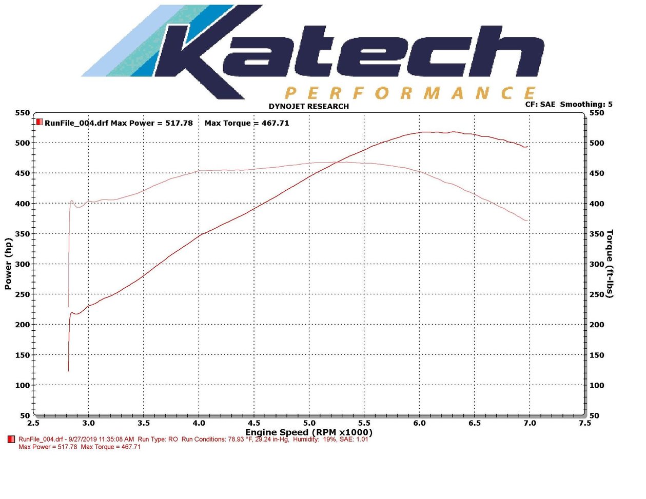

Dyno sheet:

Congrats! Sounds and looks like one bad ass machine. Dyno printout proves it.

Thanks. The rebuilt heads with beehive springs, titanium intake values, and hollow stem sodium filled exhaust valves are able to handle a much bigger cam. I could have opted for their K501 cam which would have put me close to 575 RWHP, but then the car would have had horrible low speed/off-idle drivability. 517 RWHP in a 3100lb car is plenty enough get-up-and-go for me.
