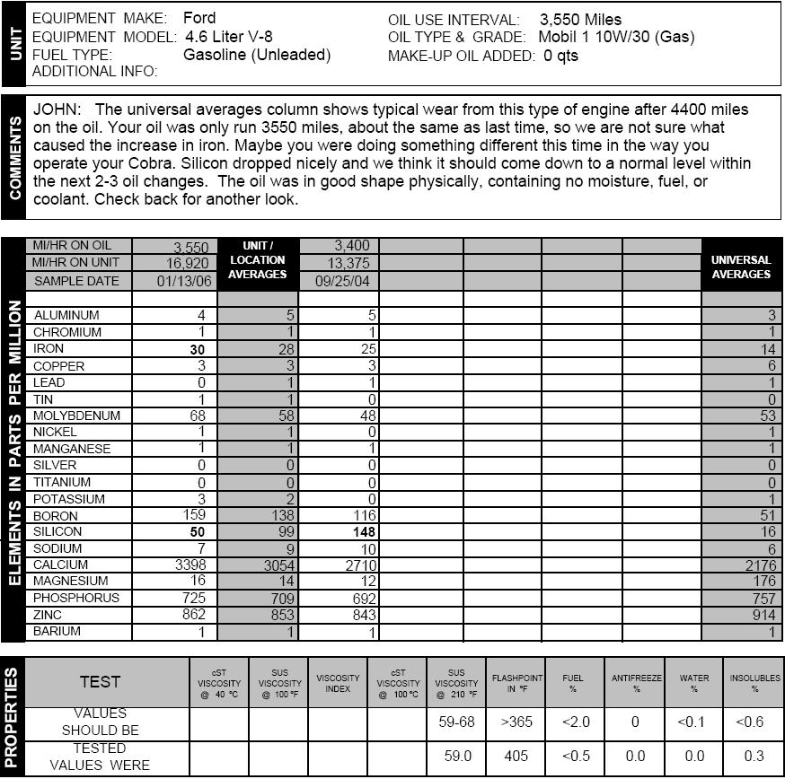

In case anyone in here is truly serious about extending their oil change intervals, or may just be curious about how their engine is holding up based on their used oil. I've posted one of my Blackstone Lab reports you get when you have your oil analyzed. The report below was for my '03 Cobra. If you look at the columns you'll see the results from 2 separate tests. One done at 13,375 miles and 16,920 miles. If anyone is interested I can dig up the report for the Ecoboost and post that too.
U.M.
http://www.kilmer-family.com/temp/blackstone.JPG
